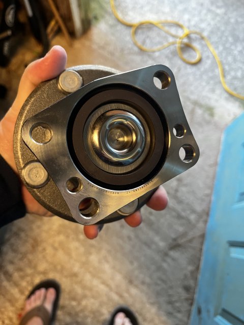

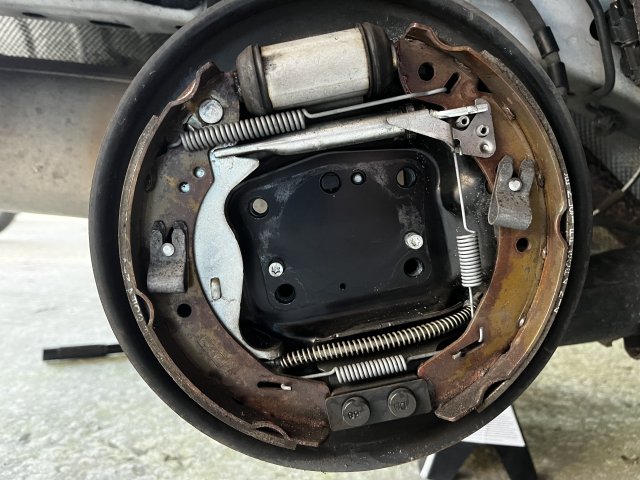

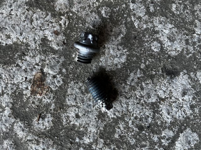

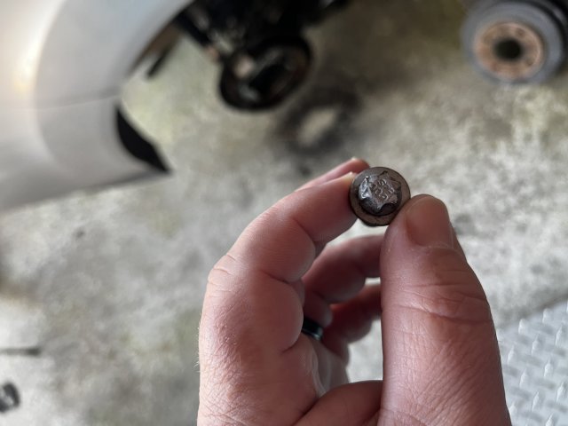

I’m in need of some help. I replaced the wheel hub/bearing assembly on my daughters 2015 Ford Fiesta. I couldn’t find a specific torque for the hub mount bolts, so I went with what I found online for a focus. After ringing off one of the bolts, I knew it must not be correct. Can anyone help me with the correct torque for the rear wheel hub and bearing assembly mounting bolts?

These bolts used may have a tapered seat and have an external "star" (torx - E12) head - so they become very unique for the purposes of holding the backing plate to the rear mounting plate, which that assembly is part of the wishbone axle and crossmember support framework.
Now before anyone flames me over that use of a Anti-seize - then they must also face the realization that the whole rear assembly plate that holds not just the hub, but the brake and the backing plate will have to be replaced as well.
