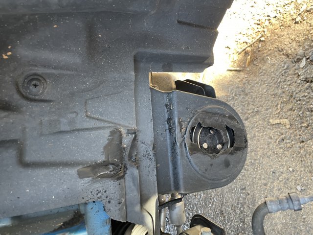

2. When the tie rod came loose, the tire turned far to the right and it scrapped off the plastic of some sort of flywheel piece that sits in front of the wheel well area. I have attached the picture.
Does anyone know what this is? It looks like some sort of sensor? I assume that it shouldn't be open to the elements like this, and I want tire shop to fix it since they made the mess in the first place.
