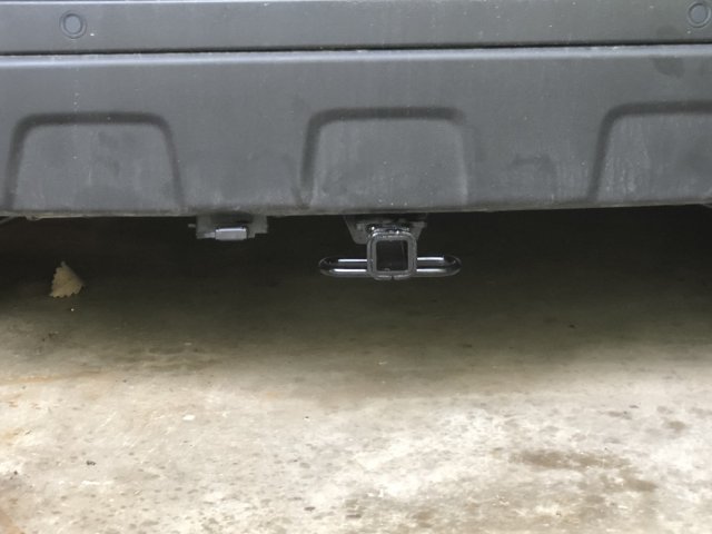

I have the draw-tite hitch on mine.
Easy to fit and when installed all you can see under the bumper is the receiver and not the frame hanging below the bumper.
As far as the trailer tow prep wiring I did find a plug under the rear drivers side it has four wires ,yellow green brown and black with yellow.
So I figure this is all I need to do is plug an extension into it that will it turn plug into the trailer.
The thing is it is a female plug with flat pins. I can not find a male plug to fit. Ford accessories web site shows a trailer tailight converter.
It should have the flat pin plug? WRONG! Also no instructions they direct you to a web site that I was not able to log in.
I just wired it up like a universal taillight converter direct to the wiring harness.

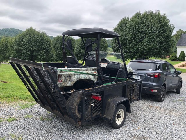

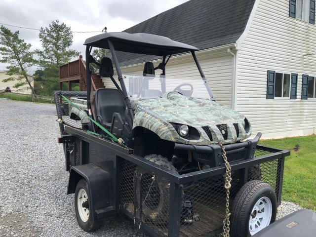

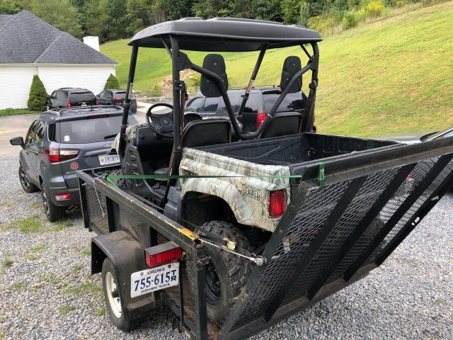

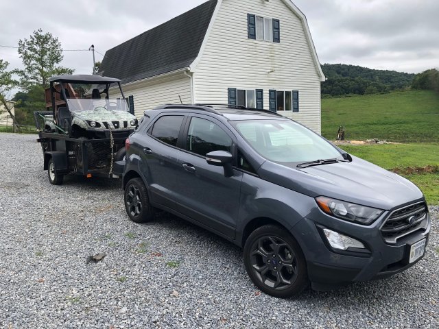

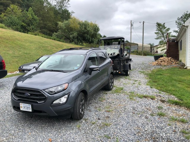

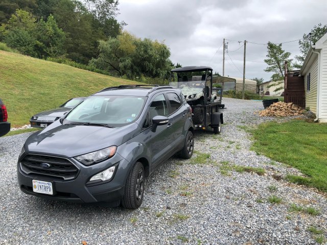

Ok let's give this towing thing a test. Made the trip from Northern Virginia to Abingdon (about 350 miles) mainly on I66 and I81. My Ecosport titanium occasioonally struggled on inclines but I did maintain about 55-60 MPH. My milage towing my empty 5 x 8 Holmes Utility trailer (Class 2 - about 800 pounds) dropped dropped from my normal 27-28 MPG to a little over 20. A friend "gifted" me a 2007 Yamaha Rhino 450 (about another 800 pounds) and today I loaded it up for the trip back. I was getting some trailer whiplash over 45 MPH but it was fine at 45 and below. MPG was about 22. When I got the trailer from pickup to his house I checked the tire pressure it was 20 in both tires. I've now inflated them to 50 PSI and we'll see what happens tomorrow on the way home. I've decided that if 45 MPH is my limit then I'm gonna drive US 11 to RT 55 back to my house (another 350 miles) the hills are a bit problematic but I never exceeded 45 MPH and 4200 RPMs. I'll report how the return trip tomorrow. Pictures attached.
