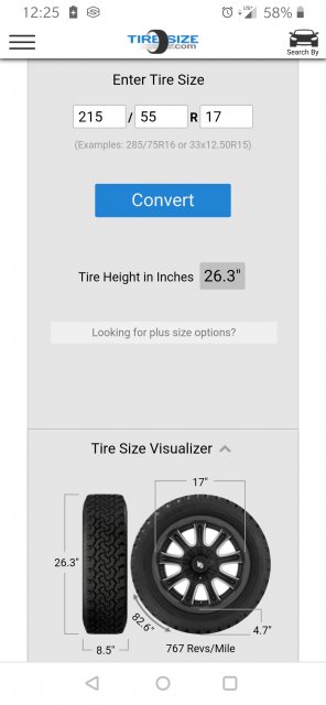

I think this tire will work. I'm about to buy these and a lift kit at the same time in case I need it to fit the tires, but I doubt the lift kit will be needed for such a small increase in size
